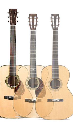

Martin makes a 12-fret 24.9 scale with an OM body, called the Norman Blake. John Hall might know particulars.
Here's a composite image I worked up a few months ago comparing from the left, the OM, Norman Blake, and 12-fret 000.
PostPosted: Mon Sep 24, 2007 9:54 am
Oops.
Here's the image.

Thanks Burbank,that`s exactly what I`m talking about with the bridge being pushed back.I guess I`m good to go to build similar to the center guitar in your picture ,except with a cutaway.If you haven`t played a 12 fret with a 24.9 scale ,it`s a real treat.

The centre guitar which is the Norman Blake model has a 19 fret fingerboard.
